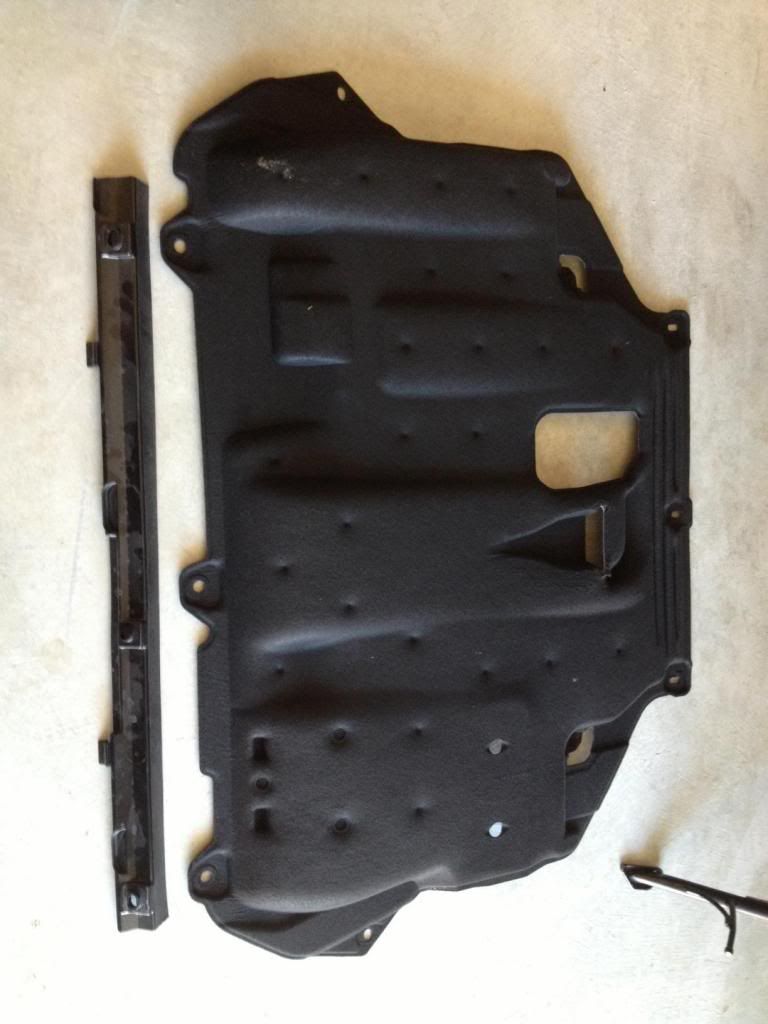

Next remove the bottom cover using your Torx bit. The ST has a little air spoiler on the front that you will need to remove first (3 screws). Once that is removed, take off the remaining screws (8), leaving the one in the very front for last so the cover doesn't fall on you. Then slide the cover forward to release it, since it slides onto features on the underside of the car. Here's the cover and spoiler:
The screws are two different lengths. The 5 longer screws go on the spoiler and on the sides of the cover. The shorter screws go along the front and the back of the cover. I put them on my bench in a little pattern to keep track. In this view, up is towards the front of the car:

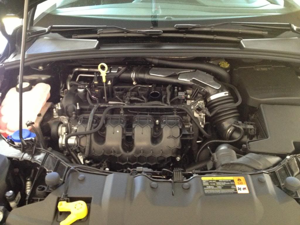

Use your funnel and add 5 quarts. Wait a few minutes and check for leaks. If there are none, reinstall the cover (remember to slide it in the mounting features first), then the spoiler, then lower your car to a level position. Add another half quart, wait 5 minutes, then use the dipstick to check the level. The ST supplement manual says the dipstick tube is part of the oil return system and to wait a few minutes before checking the level after adding oil or running the engine. If the oil level is somewhere on the hatched part of the dipstick, start the car and let it run for a minute or two. Make sure you have oil pressure. If you don't, turn the car off immediately. Turn the car off and wait 5 or 10 minutes for the oil to drain back into the pan, and out of the dipstick tube, then check the level again. Add oil until somewhere around the middle position on the dipstick indicator. I ended up using 5.7 quarts to get the level right about in the middle of the range. Check your level again the next day and top off again if necessary.

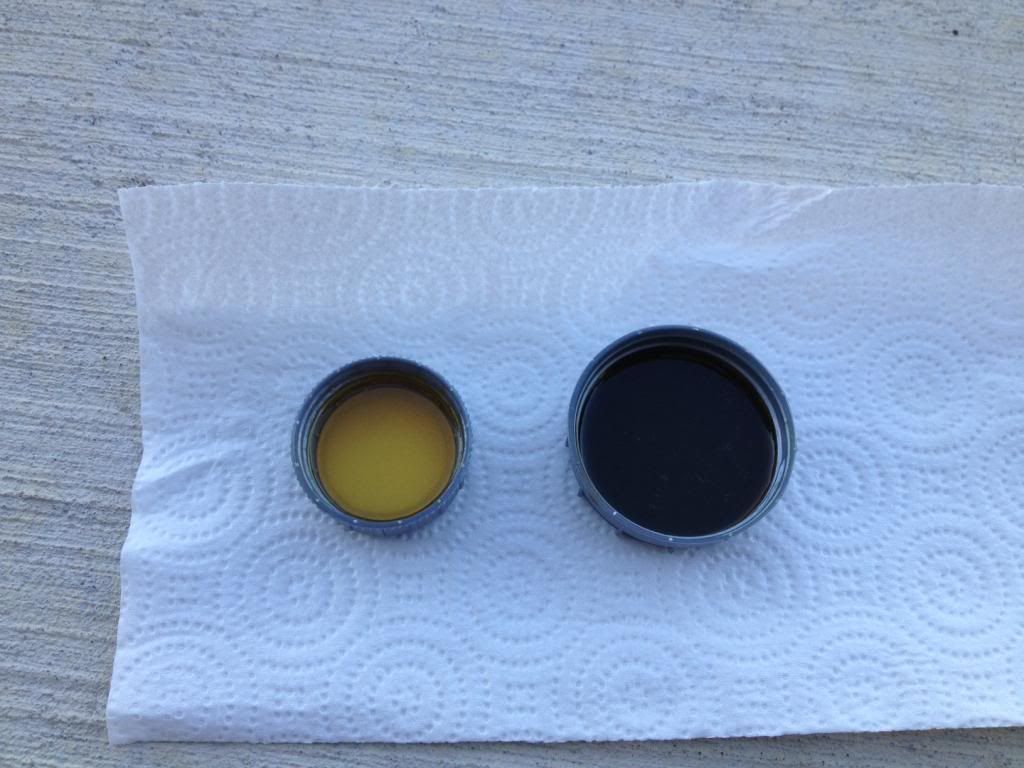

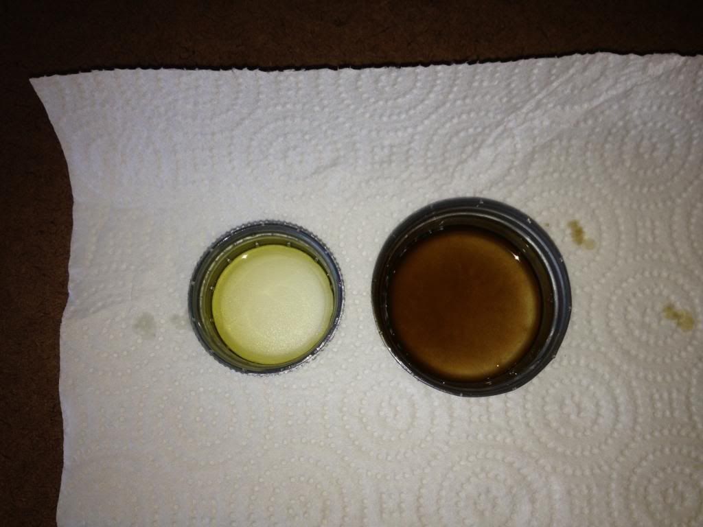

Some people say you should wait 5000 miles before your first oil change. Here are pics of the new oil and the removed oil (first pic is caps about half full, no flash. Second pic is after I poured both out, so just a thin coating on the white cap, with flash):
Please note that color alone does not indicate bad oil, indeed some brands of oil come out of the can nearly black when new (anyone know what color brand new Motocraft oil is?). However, I also found metal flakes in the oil. It might have been from the oil that I let drain from the filter, in which case the filter did its job, but I'm still glad I got it out of there. Also the old oil did not look homogeneous in color, which is impossible to capture with a camera. It looked "dirty" to me, but I am not a petroleum engineer. Take my observations as you will.

Good write up. Hey brn! I noticed the shielding on your intake is bent like mine was. My dealer got a new one from Ford with no shielding to replace mine. My understanding is that intake is discontinued. You can do the same if you talk to your dealer, I'm sure.
